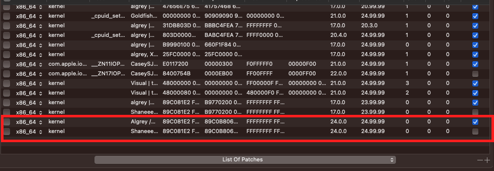

I have successfully installed macOS Ventura with Windows 10. But I cannot boot to macOS without the installation usb. Also when I shut down the machine from macOS it automatically restarts after shutdown. I tried some fixes but did not work for both of these problems. Here is my EFI:
I previously installed macOS on the same system with RX 6700xt with NootRX.kext file. I just swapped NootRX for WhateverGreen. Everything else are same as of previous installation.

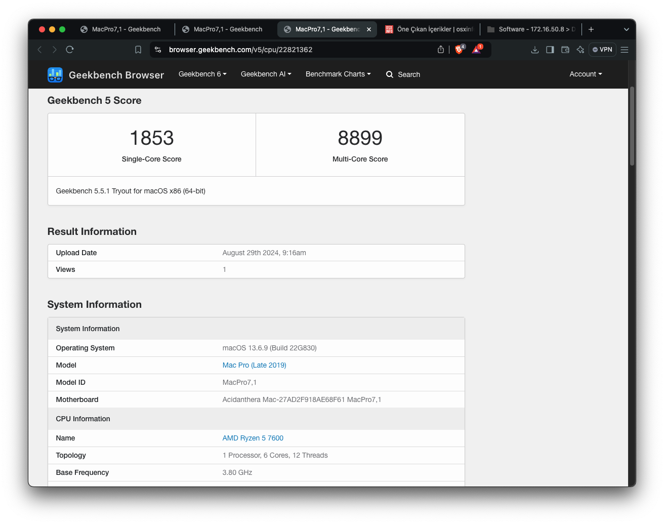

Also how can I improve it's performance? I saw typical RX 570's metal score is 40,000-50,000. I built it for video editing. I have plan to add a better GPU on it.

Activate the Shanee patch at the end of the kernel/patch tab. Disable the Algrey patch on it. Test afterwards.

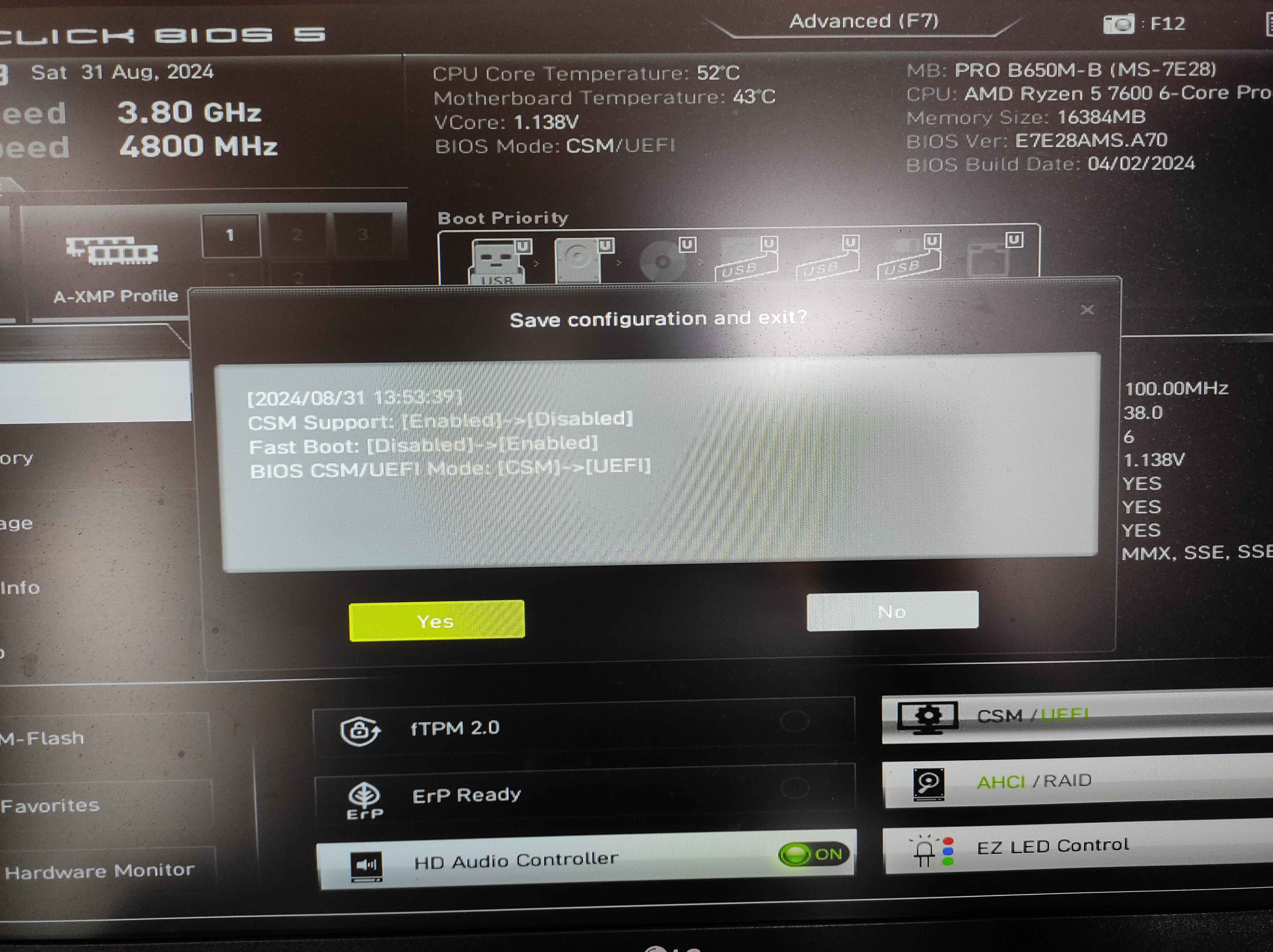

Disable
  • Fast Boot
  • Secure Boot
  • Serial/COM Port
  • Parallel Port
  • CSM
Problem GPU, Since VBIOS does not support UEFI, CSM has to step in. Search on Google "GOPUpd" (graphics card GOP update)

Disable
  • Fast Boot
  • Secure Boot
  • Serial/COM Port
  • Parallel Port
  • CSM
Here is what I am getting on GOPupd. Should I report it to their forum?
I think I can go with these two problems(Booting with usb and Shutdown). When it restarts after shut down I just turn off the machine from opencore bootloader. I am getting expected performance from it now. Metal result improved after activating shanee's patch. Thank you so much @strangerone master for your directions.
