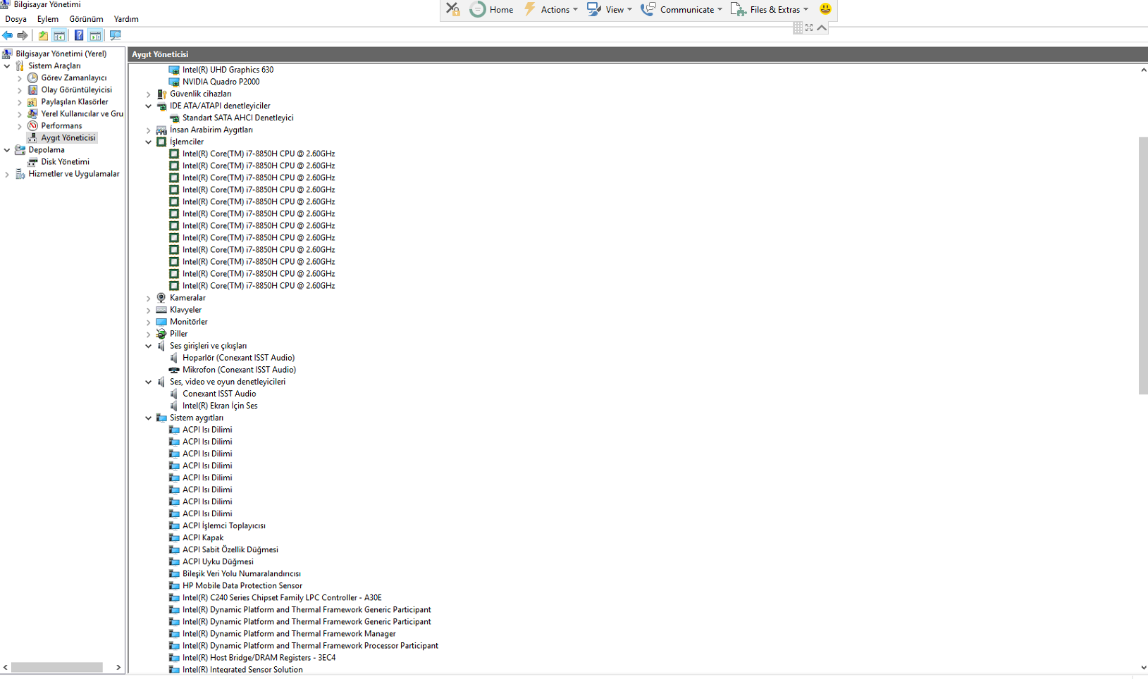

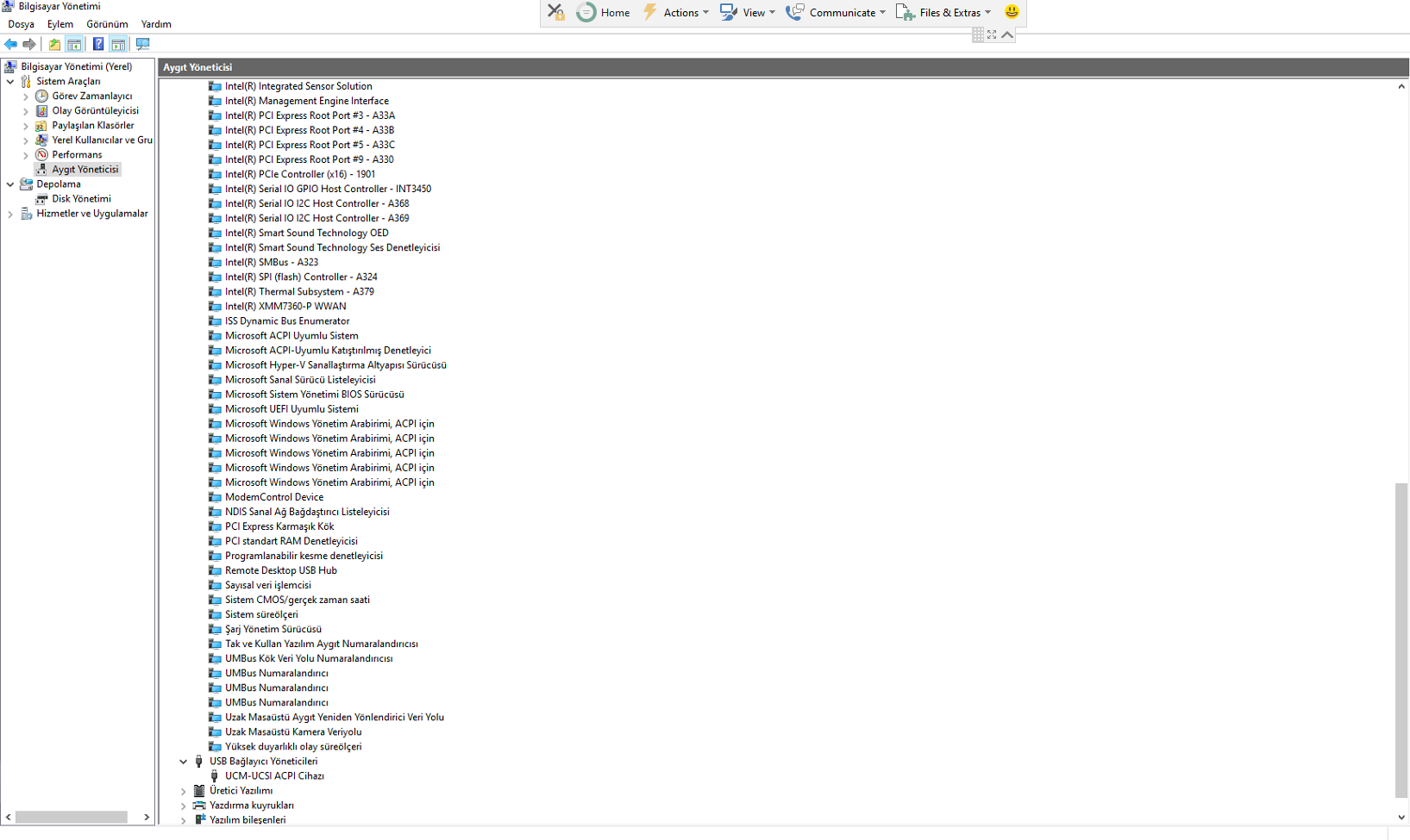

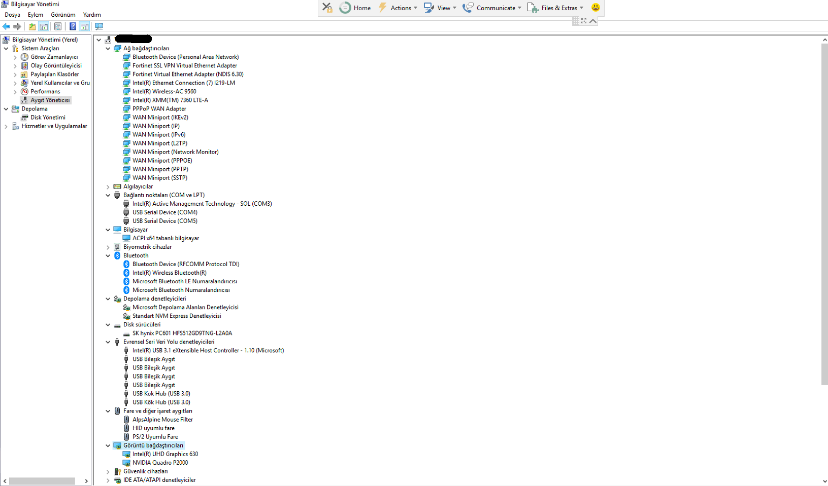

Bu arada bilgisayarımın özelliklerini aşağıda ve ekte ekran görüntüleriyle tekrar paylaşıyorum.
Zbook 15 g5 mobile workstation:
Processor 1 Type:Intel(R) Core(TM) i7-8850H CPU @ 2.60GHz
Processor 1 Speed:2475 MHz
Processor 1 Cores:6
Processor 1 Cache Size (L1/L2/L3):384 KB / 1536 KB / 9 MB
Processor 1 MicroCode Revision:BA
Processor 1 Stepping:A
Processor 1 Top-Slot 1(left):16 GB Samsung
Processor 1 Top-Slot 2(right):16 GB Samsung
Processor 1 Bottom-Slot 1(left):Empty
Processor 1 Bottom-Slot 2(right):Empty
Audio Controller:Conexant CX8400
Video BIOS Version:Intel(R) GOP Driver [9.0.1075]
Intel(R) Serial IO GPIO Host Controller - INT3450
Intel(R) Ethernet Connection (7) I219-LM
NVIDIA Quadro P2000
Intel(R) C240 Series Chipset Family LPC Controller - A30E
Intel(R) Wireless-AC 9560
