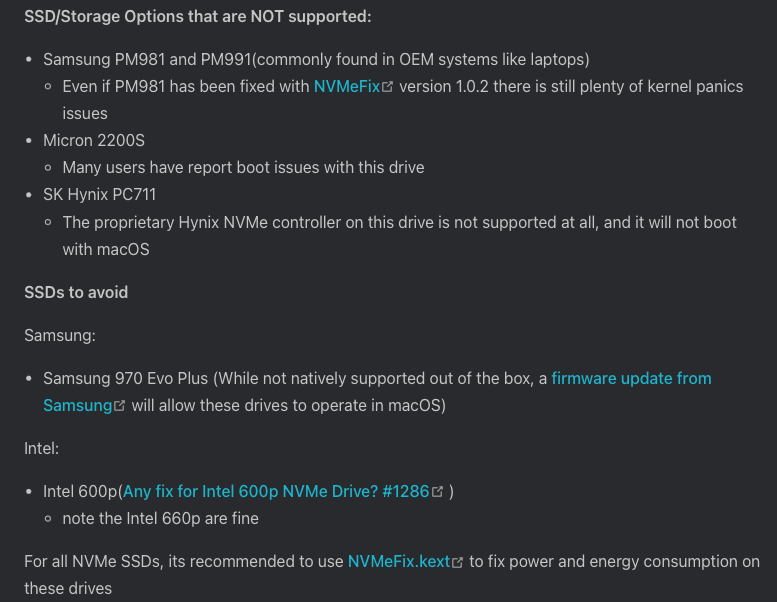

SAMSUNG_MZALQ512HBLU-00BL2 (PM991) is not a mac compatible disk. Installation is not possible.

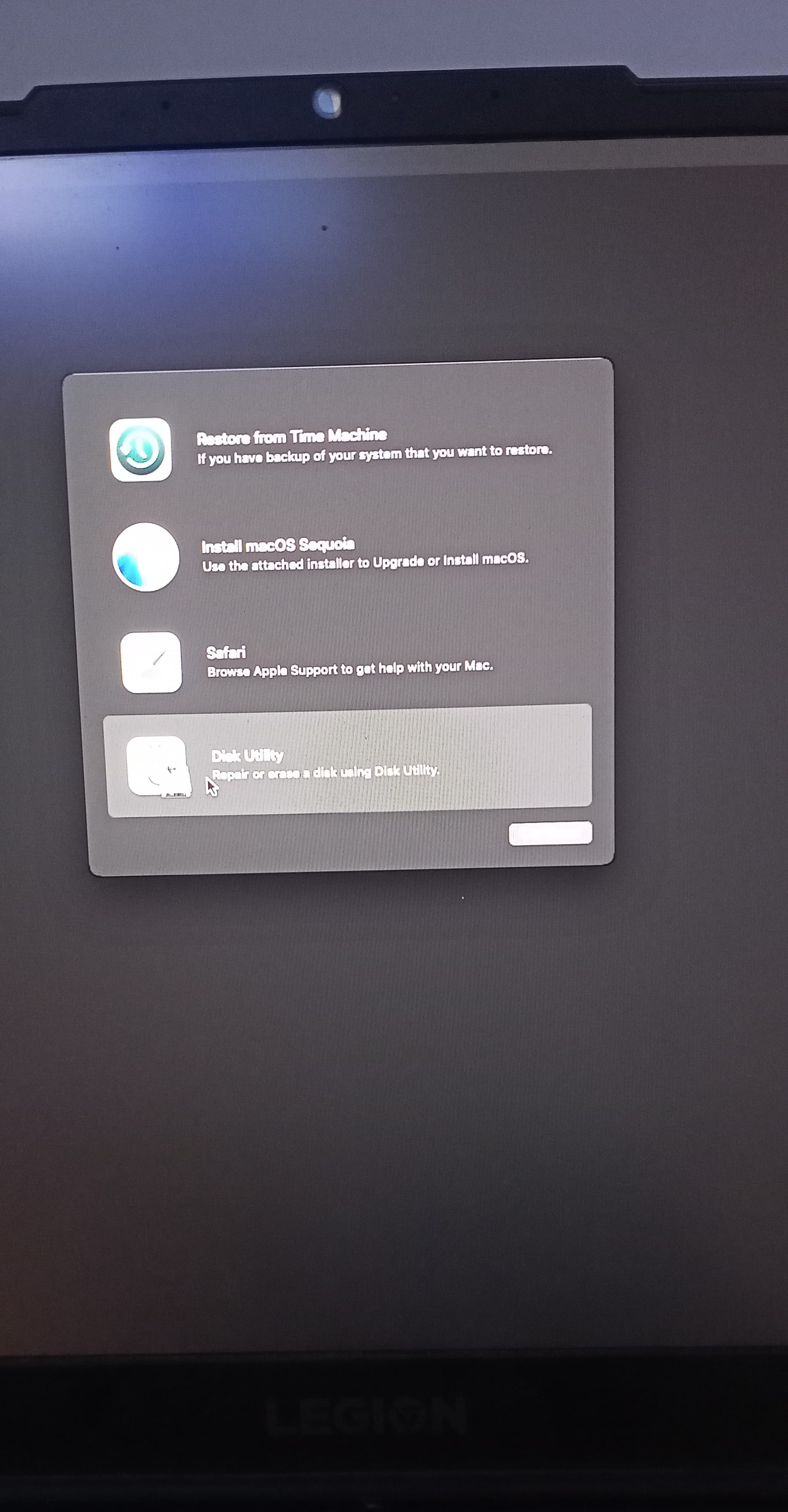

elqady4
26 Nis 2025
Congratulations. Excellent.
