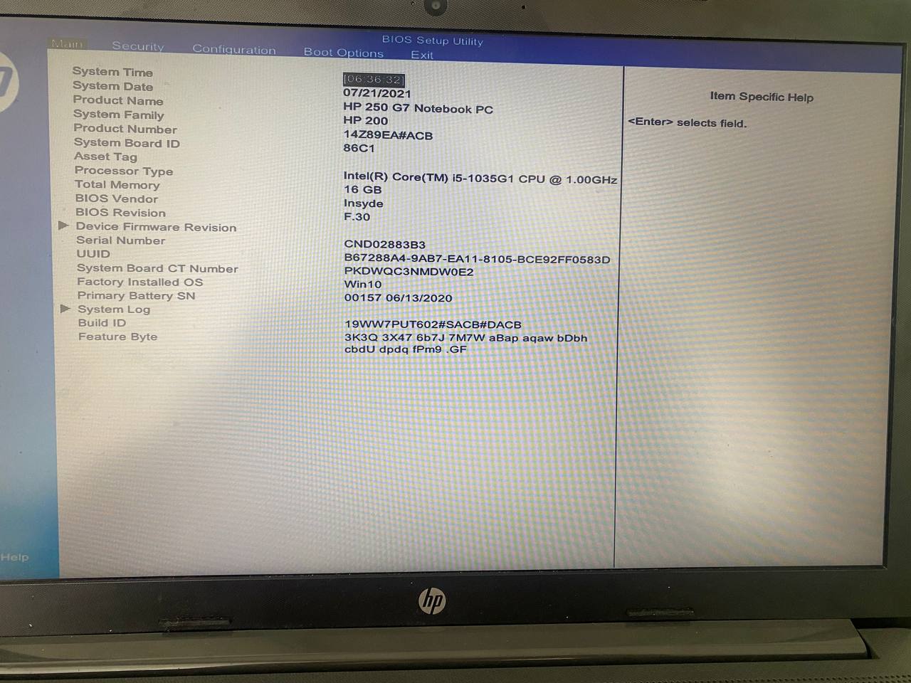

i have hp 250 g7 (i5-1035g1,16 gb RAM,256 nvme ssd, new version of bios)

BIOS IS insyde
All options like a secure boot, fast boot, ahci , disable tpm , vt-d and etc. - i do.

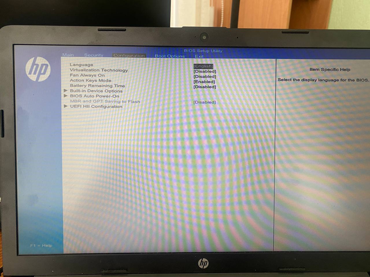

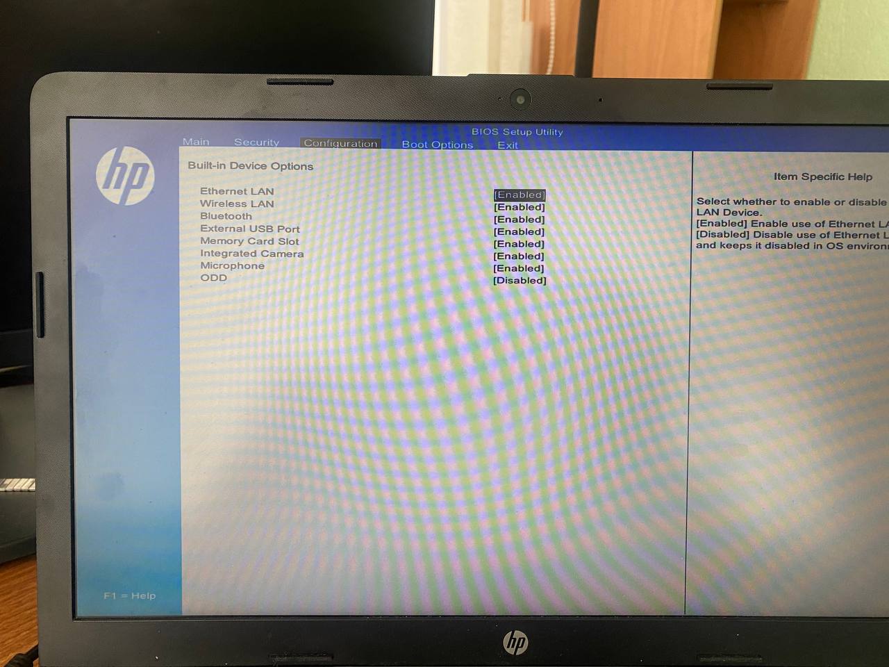

Can you share your BIOS settings with me?i try to install using your instruction but i have a new problem -HID LEGACY SHIM 2
